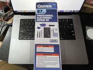

Looked at the Hazard Fraught iFixit clone toolkit - my thoughts
Receipt:
I blurred the address with my card/receipt information (this is for privacy/security reasons). The store information has also been blurred. The reason for this is the store you go to doesn't matter as the price will be the same. HOWEVER, I'm willing to provide a copy with the top address left alone and the other sensitive info blocked if there's enough demand (card info/receipt number/HF barcode). I am providing this to show I put my own money down to check this and my opinions are not influenced.

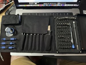

Toolkit:
First, the most significant negative I have quickly found is that the "sorting tray" is a marketing embellishment. My issue is that it lacks any sorting mechanism (such as built-in ridges that act as a sorting tray) like the iFixit driver kit is known for. This line is borderline misleading at best unless you are sorting completely identical screws.
POTENTIALLY POSITIVE UPDATE: I checked to see if the tray issue I took issue with here is resolved. IT MAY HAVE BEEN :-). The site has since changed the language to "Magnetized case with built-in storage tray." That said, I'm leaving my comment about it alone until I can check a box in person (no, I'm not buying one to check marketing corrections).

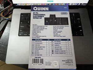

The biggest thing I immediately noticed is the bit length is marginally shorter than the iFixit bits. I don't anticipate this will be an issue, as it passed a test I use when I have it handy (I use a Wii controller). Given it worked on a Wii controller, it's marginally shorter. I don't anticipate any issues with most devices but beware: Historically difficult devices like Playstation controllers, which even struggle with the iFixit kit, will almost certainly struggle with the HF kit. To be honest, I am posting this more as a caution to anyone considering this toolkit to consider the issue before purchasing it (or at least purchase standalone drivers at the same time).
There are a few other significant differences between the HF kit vs. the iFixit kit:
- Same bit count, but some bits are missing
- Notable examples
- SIM eject
- Y000
- Y00
- Hex 2.5
- Notable examples
- The bit extension is noticeably flimsier than the iFixit kit and uses magnets for the bit retention; that said, anyone who remembers the older Pro Techs will know this was a thing with older iFixit kits until it was revised. It "works" and helps bring the cost down in manufacturing at scale, but it means you need to watch your bits closely. It's okay, but don't expect it to be as good as the iFixit extension.
- WHILE I AM CALLING THIS OUT, I'm not docking it, given the price of the HF toolkit. As mentioned above, the iFixit kit also used a magnet for a long time (original Pro Tech and early Gen2 Pro Tech revisions). It works, but it's nowhere near as good as the friction fit extension iFixit uses.
- Subpar manufacturing tolerances cause the foam that holds the bits, extension, and handle to slip out of the case. This is not an issue with the iFixit product. The top case is pretty easy to align since it uses magnets, so this will largely help mitigate issues like bit loss.
- While I'm going easy on the kit, I am a little concerned about this being a potential issue (more on this later in the "replacement part" notes). I had the same problem with two toolkits.
- Potential fix: To mitigate this, the foam is glue-friendly, so you could put a drop of fabric glue on the corners in a nonvisible area. Super Glue or PVA glue is your best bet.

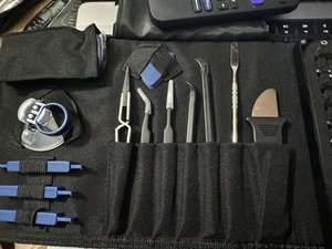

- Tool roll
- Similar to iFixit Pro Tech, but this will probably not interchange as the HF one is a little shorter. This is 110% disposable.
WHAT CAN BE REPLACED THROUGH ALTERNATIVE MEANS:

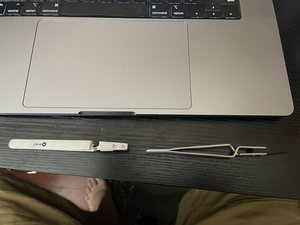

- Nylon reverse tweezers (Multiple solutions)
- Whole tweezer replacement: Cross compatible with iFixit ones or other 3rd party replacements of similar design. Not hard to find replacements on sites like AliExpress or Amazon. ($3-5 fix iFixit, less on AliExpress.)
- Tip replacement: If using replacement iFixit tips, they DO fit on the HF version. As long as it's the same or very close, 3rd party replacements SHOULD WORK but you may run into problems with future tip replacements. Bare tips cannot be readily purchased outside of buying them from iFixit; otherwise you will need to buy tweezers with extra tips Aliexpress or iFixit at an economical price. ($3 fix from iFixit, $10 Amazon with possible fit issues, ~$4 Aliexpress with extra bundled tips)
- Clone Jimmy: iFixit one fits the roll on the HF kit, this is easily replaced. NO 3RD PARTY EQUIVALENTS AVAILABLE*.
*In the US. Look up "LCD opener" on eBay for a dupe for ~$2, but this will come from China so budget a few weeks to get it. It's $8 on iFixit, so you save $6 if you can wait. IMO: Not worth it, don't buy these individually; grab at least 2 to justify the extra wait from China.Items here are readily available through multiple 3rd party sellers, there is nothing special to consider when finding replacements:
- Metal tweezers: Common design, easily replaced ($10 iFixit, $6 on Amazon, ~$1-3 for a set on Aliexpress)
- ESD strap: Generic strap, any identical strap will work. It's even a generic shade of blue for those of you who are perfectionists and want to color match the original.
- Spudger: Common design, easily replaced
Everything else looks standard or can be readily replaced with third-party replacements, like the pry tools and spudgers. However, check the measurements first. I suspect 90% of the "common" designs will fit in the roll without issues.
CONSUMBALES (included for guidance when replacing worn items):
- Guitar picks: Very common Chinese design included with things like low cost toolkits that come with a lot of 3rd party parts on eBay. Can substitute with almost any plastic pick from a music store, online shop, iFixit or Aliexpress.
- Plastic pry tools: Can't buy the orginal HF ones once broken. But anything that fits in the roll will be compatible. Check measurements. As long as it is ~3" long, it will probably fit.
