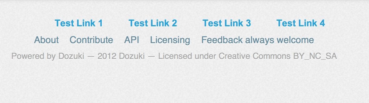

Customize your footer by clicking on "Edit" to the right of "Custom Footer HTML" under the "Appearance" tab of your Management Console. As before, this opens up a text box. If you'd like to stick with the default footer, just leave the text box blank. To change the footer, enter your HTML into the text box. If you assign an id or class, add a custom prefix so that it doesn't conflict with preexisting elements. "Save" when you have finished your edits. The HTML you enter will appear just above the standard footer. Here's an example:
