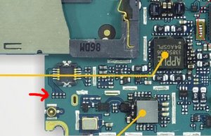

here is an example for the actual repair - not the diagnostic stuff
those 4 parts are pretty tiny - never forget that some people aren't able to connect cable 5 & 6 on the iphone (those parts are between connector 5&6)
here are a few problems you might have with this board
the use of a smd soldering iron is almost impossible - the parts are to tiny and even a new smd solderind tip is too big
so it must be hot air or infrared - since the plastic parts are very delicate - you have to be pretty careful with the temperature
the underfilled chips must stay "cool" - if they get to hot - the molten solder will crack the underfilling and the board will be dead
ahh - btw, did i mention that each of the 4 parts is tiny - the length is approx less than 1mm (no, i'm not kidding).
using a microscope and a tiny smd tip could be an option, but soldering under the microscope is not an option for me - the needed microscope will cost a fortune - and i hated it (worked as a nokia service tech).
ok, next problem - parts of that size will stick even on anti-magnetic tweezers or your fingertip and if they fall down - you will most likely never find it
that might look extreme - but it isn't - if you do component level repair - it's pretty much "common"
surely - notebooks are larger that smartphones - but the used parts are getting smaller and many computers are using the same small parts like shown above.

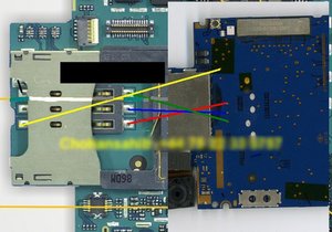

any idea what this means??
this is the "pinout" of the iphone 3g/3gs sim card reader - most likely the last resort to fix a faulty card reader(logicboard related)
there are a few internet pages with that kind of guerilla repair.
but that's not an option for the regular ifixit user - most of the time, it's the last thing you could try. some of those "repairs" are like brainsurgery with a kitchen knife - and that's something i won't see promoted here - it comes from the "underground" and it should stay there (most of the time ;-) )
